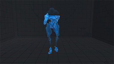

Lets Add Flickering!
In this exercise we'll learn how to modify our shader to creating a flickering effect. This is a useful technique in creating a hologram that seems to be going in and out or just as a way to create something a bit more unique. Taking the techniques taught in the original Hologram shader chapter, we'll essentially reverse some of the effects and apply color to smaller scan lines while using the bigger scan lines to affect the alpha of the mesh. The bigger scan lines will effectively create a flickering or scanning effect since it will control what part of the mesh will be visible at any point.
